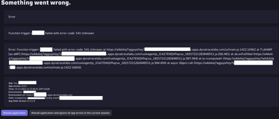

Function trigger-function failed with error-code: 541 Unknown
Radoslaw_Szulgo
Dynatrace Guru
Dynatrace Guru
What is HTTP Error code 541 mean when trying to call an app function? The app function calls an external service. How to troubleshoot this?

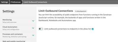

OK. Good hint! Indeed we're using a custom endpoint via the AWS API gateway. For the sake we've disabled the limitation to outbound connections to endpoints in the allow-list like that:
This helped. We'll turn it on and add our endpoint to the list. Thanks Dirk!
