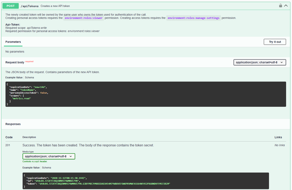

  I am wondering if there is a any way to automate the token creation via a script without revealing the token?.
I am aware that we can use the respective Environment APIs like POST/PUT etc.
But in order to have the access to those API creations first we need to have the authorization token - By generating that from the /ui/access-tokens/create?gtf=-2h&gf=all (With the correct scopes say api.Tokens.write)
Assuming if any automation on generating the master token automatically via some script . My idea is to automate this token generation and use that authentication during  run time of my script, to  invoke other APIS with different scopes.
My concern is on  creating the token via the manual existing method.
It is not user friendly as one need to create this token every time for security reasons as the token cannot be stored anywhere.
On checking if we can use the credential vault for storing environment tokens , don't see it is  possible.
Having the token stored in say some other vaults like Hashcorp or cyberark seems to be too many dependencies.

Maybe I read this wrong but overall you will always need a primary token manually made, to then leverage some sort of automation.
So lets say you built a Home Grown Self Service App, where users can request an API token with the scopes they need... or lets say you built an integration in ServiceNow which will allow you to have a user Request token Scope access and supply required information like Expiry, Justification as well as gaining manager approval. Once approved, Service now, or your home grown app, could post the request into Dynatrace and export the token value to a targeted repository, be it Cyberark or something in ServiceNow. But to do this, you would need to first Manually create a Master Token that will allow your Home Grown app or ServiceNow to  PUT the API call:
I would recommend enforcing a naming convention too that outlines the ServiceNow request for audit abilities. The question will come - "Why did Joe get Delete Access via API? Request 123456.... Ahh, Kevin approved it with this justification."

Going an extra level, we had a use case where we needed to delete a set of log files. In order to delete these files we : 1 - needed a Cluster Token. 2 - Take that bearer token and decode it 3 - Use it before the decoded bearer token expires. So we formulated a script that called the Cluster, got the bearer, decoded it, then posted the delete of the logs, while then every 2 seconds checking the status of the delete.
While that was all automated, it still resulted in manual action of creating the primary token for the script to use.
