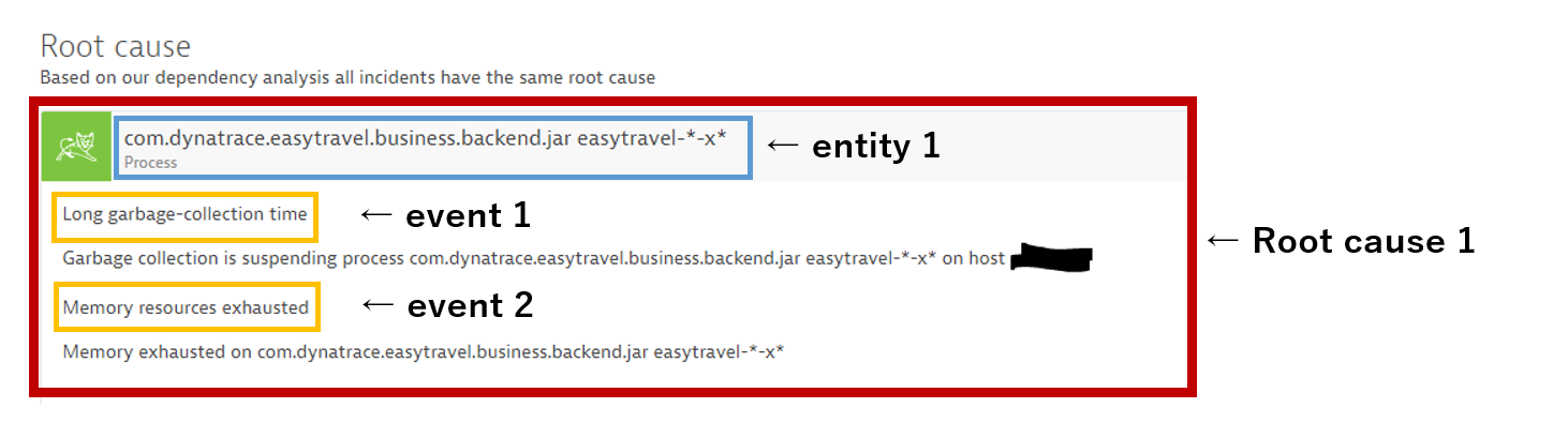

The confusing part is in the Web UI where multiple event findings such as Garbage collection event and memory event on the same entity are grouped into one entity card, shown in your screenshot. Those detailed information are exported as list of single events within the UI.

Here, let me consider an example shown in the following image.
(1) This problem has one root-cause and it is "Root cause1".
(2) "Root cause1" is composed of one entity and it is "entity1".
(3) "entity1" has two events and they are "event1" and "event2".
I think what you were pointing out is (3).
I didn't think of it until you said, as the above, certainly a single root-cause can be related to multiple events.
However in fact, what I really want to ask you is whether "eventType" has the unique event presentation or not.
Taking the previous example, I used "event presentation" or "statement" as a meaning of the context surrounded by the yellow box.
When I got the REST export about this problem, I found "entity1" in the exported JSON and this have some events which are related with "event1" and "event2".
"event1" have "HIGH_GC_ACTIVITY" in "eventType" field and "event2" have "MEMORY_RESOURCES_EXHAUSTED".
I wonder whether it is always shown as "Long garbage-collection time" in WebUI when "eventType" is "HIGH_GC_ACTIVITY" or not.
This is just an example , and to make it simple, my question is whether "eventType" defines uniquely "event presentation" on WebUI or not.
