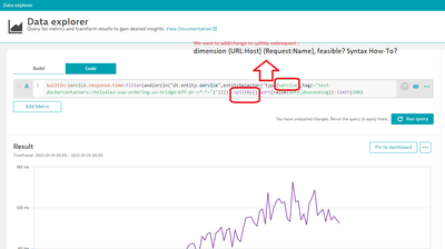

Our goal is to use "data explorer" coding approach to display multi-dimensional report without using custom metrics.
Use case:
#0.  This code working in data explorer:
builtin:service.response.time:filter(and(or(in("dt.entity.service",entitySelector("type(service),tag(~"test-dockercontainers:chnlsales-soe-ordering-ux-bridge-bff-pr-v*-*~")"))))):splitBy():sort(value(auto,descending)):limit(100)
#1. Now we want to change type(service) to type(webrequest???) instead, so that we can get the statistics by dimension {URL:Host} {Request:Name}, then pin the report to dashboard.
Below syntax failed, what should be the correct one? is it feasible? Please note we TRY TO AVOID setup custom metrics which will cost us many extra DDU license charge.
builtin:service.response.time:filter(and(or(in("dt.entity.service",entitySelector("type(webrequest???),tag(~"test-dockercontainers:chnlsales-soe-ordering-ux-bridge-bff-pr-v*-*~")"))))):splitBy():sort(value(auto,descending)):limit(100)
Demo screenshots:
Figure1 > Goal to get result like below: Split by dimension
Figure2 > we want to use "data explorer" coding approach to get results in Figure1
