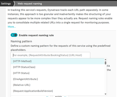

08 May 2026 10:02 PM
To answer my question above, you can click into the Naming Pattern field in the UI for creating a Naming Rule for any Service to get the list:
