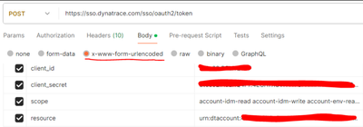

Hi Elena,
Maybe I didn't explain myself well. My problem is that I can't get a Bearer Token. After creating the OAuth2 client, requesting the bearer token from the Dynatrace SSO system via an API call fails. This API Call fail:
https://sso.dynatrace.com/sso/oauth2/token (POST)
and it gives me an http code 400 (Bad Request).
the python code in the previous post explains it well
I hope I explained myself.
Thank you

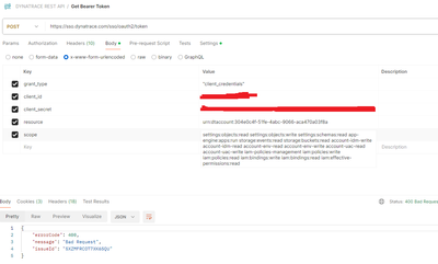

14 May 2024 10:27 AM
Sorry Helena,
but it failed again....
Follow Postman Request.
This thing is driving me crazy!

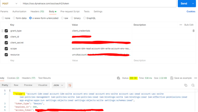

14 May 2024 10:49 AM
Hi Hazard,
This is my configuration on Postman and returns the bearer:
The only difference that I see it's the "grant type" key. You could try to remove it and test if it works.

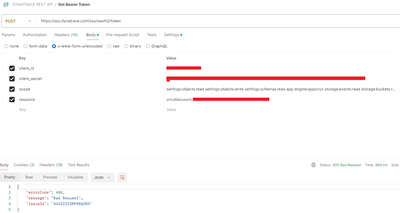

14 May 2024 11:00 AM
Hi Helena,
I removed the "grant_type" key but I still get the same result. It doesn't provide me with the bearer.....
14 May 2024 02:59 PM
Hi again Hazard,
Adding "grant_type" it also works:
In the answer of the POST you can see the used scopes.
Please, be sure that the value of "scope" key contains the same scopes you have defined for the client_id on Identity & Access Managment > OAuth clients. And also be sure the client_id is the desired client_id you want to use.
If it doesn´t work, I'm afraid I haven´t more ideas.
Regards,
Elena
12 Apr 2025 12:03 PM - edited 12 Apr 2025 12:10 PM
Hi @Hazard remove the quotes around client_credentials for the grant_type query parameter.
You had it like this:
But it should be without the "" around client_credentials, like this:
I confirmed it in Postman, with "" it breaks.
