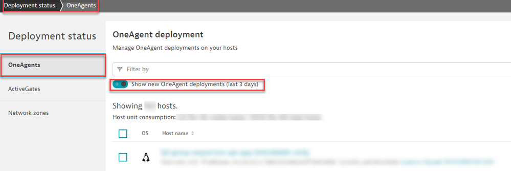

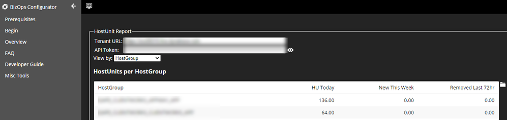

So you could use the deployment status page to see the hosts that have recently onboarded hosts in the past 3 days. You could also use the BizOps Configurator to see the new Host unit consumption per Host Group or even Management Zone, but it wont give you the host ID.

#1. Q: BizOps Configurator > Where I can get this? Is it free tool?

Biz ops configurator can be found here: https://dynatrace.github.io/BizOpsConfigurator/#prerequisites It is free, and you'll need a token for your environment, the instructions are well layed out.
