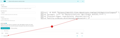

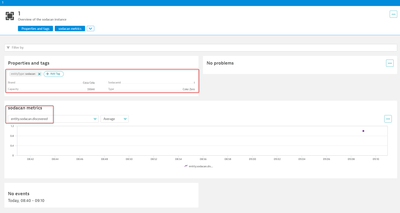

Extending what Chad said, you might want to look at the new generic entity model. Basic workflow is:
You can see your soda cans by going to abc123.live.dynatrace.com/ui/entity/list/entity:sodacan

Hi Conal,
Correct. In this case you'd define a new generic entity called sodacan and set the extractionrule to be some string (in my case sodacanid)
Then whenever you pass a metric, a new entity (think of an object in OOP) will be automatically created based on that unique ID.
