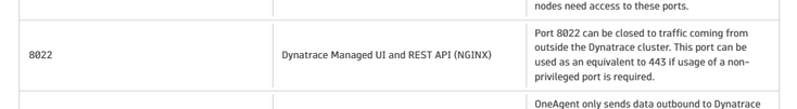

I think you can diable the 8022 port.
Cluster node ports — Dynatrace Managed Docs

You should block this port using the node's local firewall (iptables/nftables).
Changing the certificate on the dynatrace server process (the one listening on 8022 tcp port) is not supported. All communication to cluster node is through the NGINX where you are in control the certificate (or you use Dynatrace issued certs if you use *.dynatrace-managed.com domain).

@HuseynNajafli, the only supported way of changing certificates is this one. You shall not try to change any certificate manually by editing config files or changing any certificate stores. This replaces the certificate on the NGINX - and all communication to the cluster node goes through it - except communication between cluster nodes.
