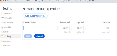

Unfortunately, in most cases, support recommend directly uploading the archive to the server. If this option is not possible for you, you can try the following:
The root cause of the download fails in third-party utilities that control the network (for example, between two network segments)
If you can talk to the specialists responsible for this - about switching off for a while or adding rules - so you can upload the archive.
The connection can also be broken not after reaching a certain amount, but by the amount of data transmitted during the time.
You can try to limit these settings in a browser (for example, chrome) and try to upload the archive. Perhaps 2-3 hours later - instead of 15 minutes - you will upload it, because the network control utilities will not break your connection. I had such a case. Hope this helps.
