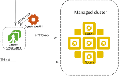

the cluster activegate communicate with the port 443 of dynatrace cluster:

Yes it's one of the deployment scenarios
https://docs.dynatrace.com/managed/shortlink/managed-deployment-scenarios#scenario-3-integration-wit...
Agents to Activegates: Port 9999 (Can be customized)
Activegates to cluster: Port 443
