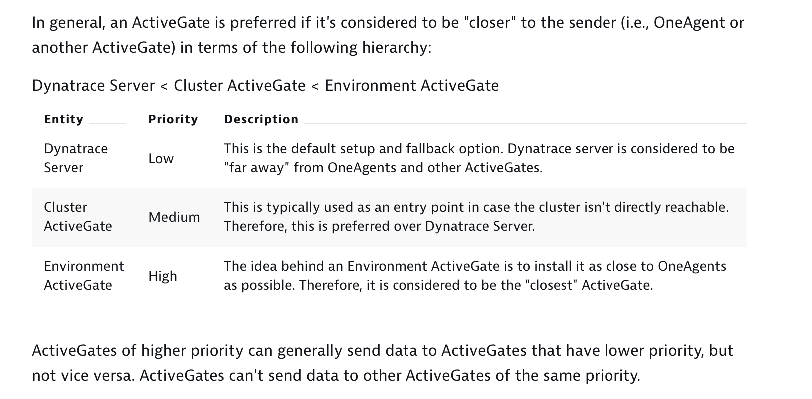

According to this doc, OneAgent will prefer AG that is closer. In such case this shouldn’t be issue for you.

I understand the hierarchy of preference between the Environment and Cluster AGs and of these over a direct connection to the cluster, but that view of closeness does not relate to the actual network distance.... so when we have multiple Environent AGs (as we do) the documentation does not appear to state that the one that is actually closest or has the least latency will be selected.
