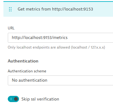

Has anyone been able to get this functional, specifically using the local deployment method? I was able to add a netshoot container into the coredns pod and run curl http://localhost:9153/metrics which produces results. This tells me that the metrics are exposed right? I've also confirmed that the OneAgent version we have is 1.299 and via the AWS console I'm seeing coredns version v1.11.1-eksbuild.8.
Here is the configuration I have setup in the extension but I don't see any metrics coming in and the status of the configuration is in Error with nothing to further note the issue. I've also setup the configuration for a scope of the mgmt zone in which this cluster is in so I wouldn't think the scope of the configuration is the issue here.
Anyone know what else I can look at here? I've also have accessed 1 of the underlying nodes where coredns is running to look at the oneagent logs, I don't see anything within /var/log/dynatrace/oneagent/extensions/datasources. Normally the extension if being downloaded would be here right?
I did look into the extensions app (the newer one) and into the configuration health. I'm seeing DATASOURCE_UNSUPPORTED but I don't know how to fix this.
05 Nov 2024 09:04 PM - edited 05 Nov 2024 09:19 PM
As an update here I got to looking around and found that this seems to need to be enabled at the k8 cluster settings in dynatrace. I enabled it then added these 2 annotations to the coredns pods and I see the metrics now. I'm still seeing DATASOURCE_UNSUPPORTED for the configuration health but I am seeing the metrics, not sure what this DATASOURCE_UNSUPPORTED is and how to fix it.
metrics.dynatrace.com/scrape: 'true'
metrics.dynatrace.com/port: '9153'
