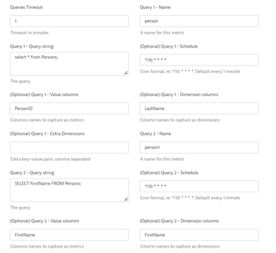

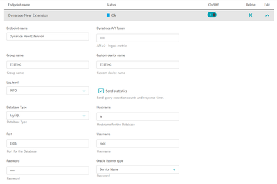

Hi all,
We have configured the same but not getting proper output metrics.
can you help me to configure the same?
Actually we want the output of custom query and set alerting on the output of that query.
In data explore we are not able to get the db output matrices.
We have mentioned the configuration and output below,
OUTPUT:
Thank you in advance.

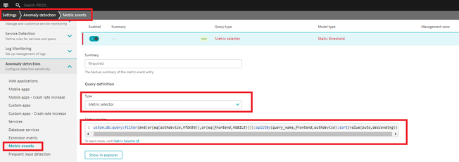

Hello Mizso,
How we can set the alert/threshold on  output of custom query ??
Hi @Shivanish,
Custom query create a metric: custom.db.query. You can use it to create a metric event.

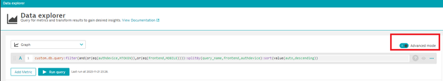

In data explorer you can create a metric expression by splitting and filtering your custom db query metric by its dimenasions. Here is an example:
Create metric expression by advance mode you can copy it to the metric event creation:
Create a metric event by the metric expression:
Then you need an any alareing profile and a problem notification integration eg, for e-mail alerting.
