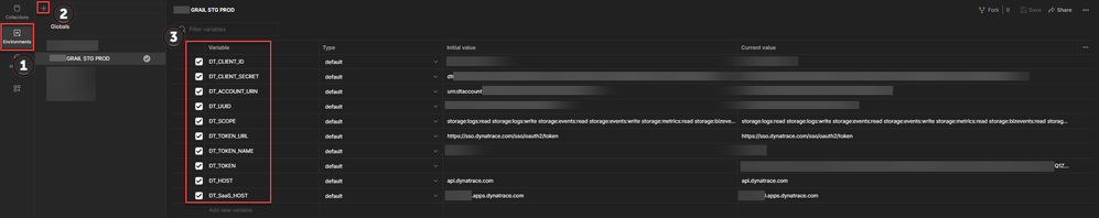

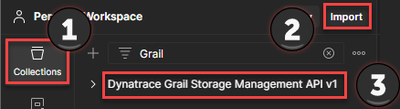

Import

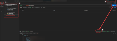

Get your Bearer Token
Using Collection
At this point, if you are receiving Required permissions not met it means that the Oauth 2.0 Token is working, but you are lacking the Dynatrace Identity and Access Management (IAM) framework permissions on the user you assign the Oauth 2.0 Token.
