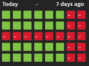

I have done similar trick to allow Single Value tiles to become as tiny as possible. They can be shrinked into 38x38 which is 1x1 in the GUI. This enable you to make very simple and small traffic light indicators to anything that can be resolved in Single Value graphs.
Absolutely great if you need a lot of input covered in smaller areas!
14 Aug 2024 10:06 PM
Thanks alot! but when resize these tiles in JSON they become un draggable ? is there away to avoid that?
15 Aug 2024 07:58 AM
Since i made this, there's been implemented a few things that makes it harder to work with. Sadly I haven't found a way to move them after they've been shrinked - so you also have to plan for where they should be placed.
15 Aug 2024 01:55 PM
I appreciate your quick response! at least you found us solution.. I had tried finding JSON attribute/definition for TILES like "dragged=enable" but no LUCK 🙂
