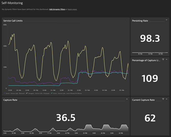

Recently I ran into an issue at a customer where data-quality dropped. I figured out that this had to do with adaptive capture control implemented for Dynatrace SaaS.
I had some fruitful conversations with Dynatrace Product Managers on this topic. And I thought it's important to share this with the community as well.
It was confirmed that SaaS adaptive capture control can limit the processing of service requests to a state where the data gets really aggregated a lot. This is not necessarily a bad thing but it really depends on your architecture, and it can have these impacts:
If your architecture (or what you are monitoring of it with Dynatrace) has lots of services and a high amount of service calls (e.g a few 100k/min) you might feel the impact.
Similar to what is described in this blog post for Dynatrace Managed I recommend to also implement some health monitoring for Dynatrace SaaS, specifically for the adaptive capture control.
Monitor Service Call Limit and Capture Rate
Some of the metrics described in the above blog post are also available and relevant in your SaaS tenant.
I'm using this dashboard to get an idea of the status of capture control in my SaaS tenant (dashboard is attached to this post):
What you can see in the above screenshots are the attempts to get back high fidelity data by improving the capture rate again.
What are we seeing there:
Out of these metrics we can calculate the capture rate and how much of the limit we are consuming.
As you can see in the chart we have put some effort into increasing the capture rate, mainly by increasing the limit for this environment. We are not there at 100% but getting close now (we moved from 15% capture rate to 62% but will likely increase the limit a bit more).
