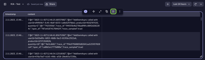

1. New Dashboards - The new views do not yet support export to PDF. However, there are three options for extracting data from them.
  • Screenshot - simplest however very limited
  • API - It is possible to retrieve data via API from already finished metrics, however, this already requires knowledge of the programming (monitoring bridges do not always have such knowledge)
  • RAW Data - retrieve the data that is returned from the prepared queries.

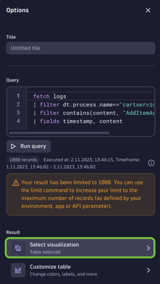

To do this, select "Option" on the selected visualization.
Then click on "Select visualization"

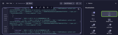

Select the "Raw" visualization option. You can download and further process the data displayed in this way, for example, in Excel.

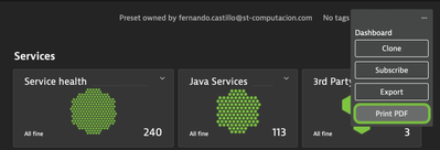

2. Classic Dashboards - In this case, the matter is much simpler, since Dynatrace provides a Print to PDF function.

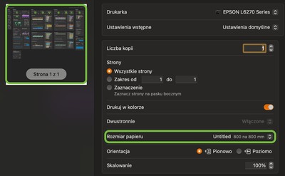

However, when printing a PDF, you must select the correct print size (Paper size). I'm describing this because one of my customers even reported to support that this option does not work.
