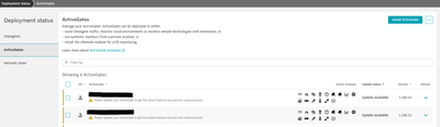

I only see from "Deployment Status - ActiveGates - choose one of them(in my case two) - Settings - Update button"

Oh I see. So you do have your ActiveGates pointing to the client's tenant -- they show up under Deployment Status, meaning the actual ActiveGate software is set to to the client's tenant.
So you have both the DB servers and the ActiveGates in the same tenant, so you're good. You should update those AGs to version 1.301 or higher (you can do to this from the Deployment status screen) and you're good to update the extension.
