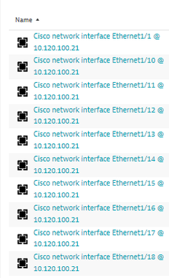

I have a question about the , which was to be able to filter the network interfaces. I'm telling you this because this is not documented in the extension and there is no example of how it is filtered correctly, with the F5s documentation i was able to find which patterns can be used.
https://docs.dynatrace.com/docs/platform-modules/infrastructure-monitoring/networks/f5-extension
For example, I already managed to filter correctly using this pattern which shows me everything as it should be:

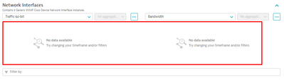

But when I try to place two interfaces it always fails and doesn't show me any information:
$eq(Ethernet1/1, Ethernet1/13 )
$and(Ethernet1/1, Ethernet1/13 )
$eq(Cisco network interface Ethernet1/1 @ 10.120.100.21, Cisco network interface Ethernet1/13 @ 10.120.100.21)
$and(Cisco network interface Ethernet1/1 @ 10.120.100.21, Cisco network interface Ethernet1/13 @ 10.120.100.21)
I tried with all those patterns and none of them work for me, they all show me blank information because it doesn't match.
Can anyone tell me what the appropriate pattern is to add more than one interface?
Regards Bryan
