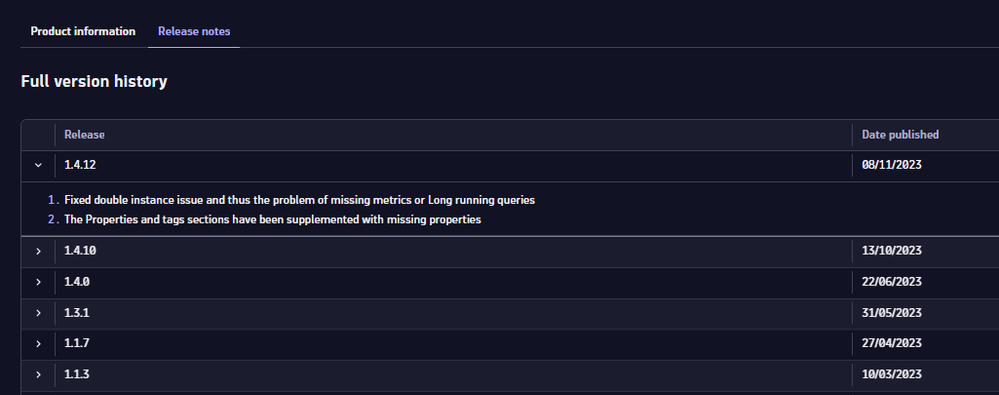

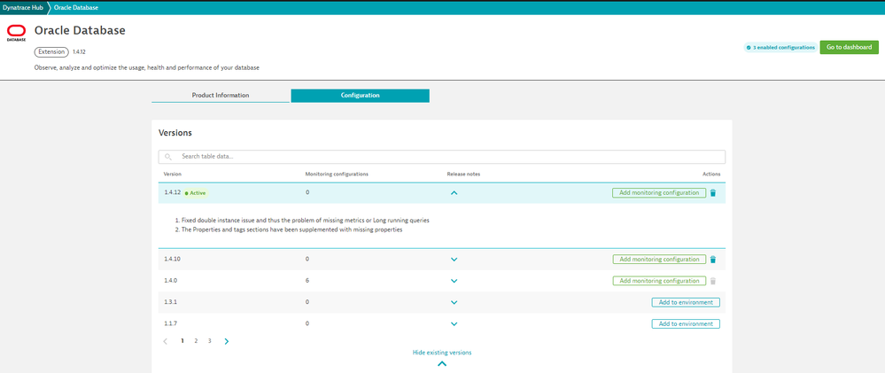

Where do I see the download option here in release notes?
Did not found neither in my extension config nor in the hub page:
