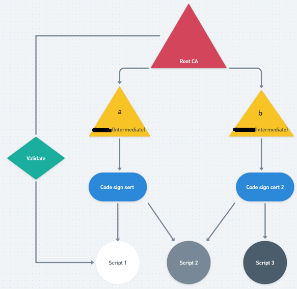

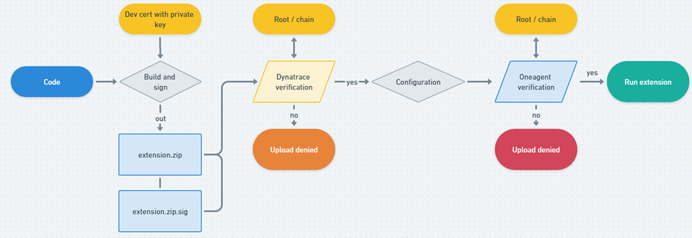

You can have several root certificates uploaded in the certificate folder, however that may defeat the benefits of signing extensions in the first place.
If you want to ensure that only your trusted developers are able to upload extensions, please consider the following:
Detailed sketch on how Extensions 2.0 are validated and ran.
Workflow
Example on how additional security is being added to different systems using several intermediate CA's in a domain. Please ignore "script 2" in the sketch, as an extension cannot be signed by multiple signers (yet)
Additional security
Let me know if the figures attached will help you determine what the best course of action will be for your environment.
