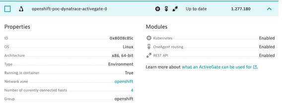

Failed to assign monitoring configuration to ActiveGate. Reason: The monitoring configuration requires ActiveGate version 1.256.0 or later that supports data source prometheus and belongs to group "openshift"
However, I've confirmed that my installation of ActiveGate is above this version. Some searching online has led me to believe that the reason for this is that I don't have extensions 1.0 & extensions 2.0 module enabled for my ActiveGate, which appears to be the case as it doesn't appear on the list.

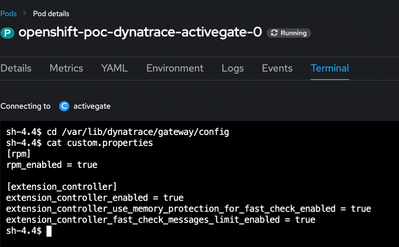

From here, I've tried editing the configuration directly on the OpenShift pod generated from the auto-configured StatelessSet, referencing the instructions here: https://docs.dynatrace.com/docs/setup-and-configuration/dynatrace-activegate/configuration/configure...
I had to use the following to edit custom.properties as oc isn't available on the pod.
cat > [file]
    [rpm]
    rpm_enabled = true
    [extension_controller]
    extension_controller_enabled = true
    extension_controller_use_memory_protection_for_fast_check_enabled = true
    extension_controller_fast_check_messages_limit_enabled = true
ctrl+d

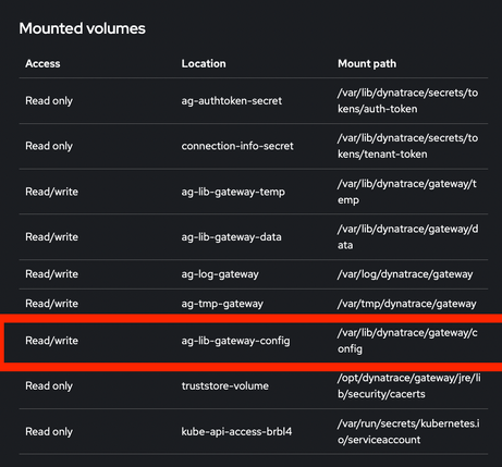

However, upon restarting the pod, I've found that my configuration is overwritten despite the instructions suggesting otherwise. This seems to be because the Mounted Volumes aren't persistent and always reloaded from my base image for the auto-generated StatelessSet.

Hi @iqwertyier
In order to run Extensions 1.0 and 2.0 you need an AG running on a Windows or Linux host (s390 host-based and containerised deployment are not supported)
https://docs.dynatrace.com/docs/shortlink/activegate-capabilities#functional_tbl
