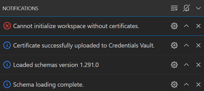

I am trying to modify SQL Server Extension 2.3.0 using Visual Studio Code but I found a notification of "Cannot initialize workspace without certificates":
Do you know how to fix the problem? I believe the certificate is successfully uploaded to the Dynatrace credential vault and what next?

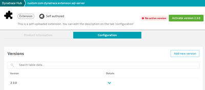

Hi @AntonioSousa ,
I have successfully initialized workspace yesterday.

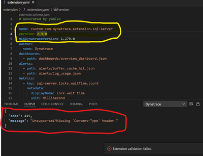

I have renamed the sql server extension to custom but I got error code of 415 when I built the custom extension:

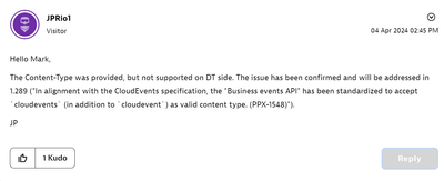

I have used the latest schema (1.291.0) because someone said the error will be fixed in schema 1.289.0:
https://community.dynatrace.com/t5/Dynatrace-API/Cloudevents-ingestion/m-p/236483
Any suggestions on how to upload the updated sql server extension?
