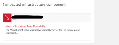

Community,
I am using filesystem monitoring extension to monitor the mount points availability which works perfectly fine. While generating problems it does not contain the file system path which got failed.
Kindly help on how to add the Property field in the metric events to capture the filesystem path.
I am aware we can create metric event for individual path based on the entity selector but I wanted to create a metric event more generic and applicable for current and future mount points monitored
18 Jan 2024 10:01 AM
The path is stored in a dimension called path so you can add it to your problem description for instance by using {dims:path} in your metric event definition
18 Jan 2024 11:46 AM
Hi Florent,
I tried using (dims:path} in the description and its not working.

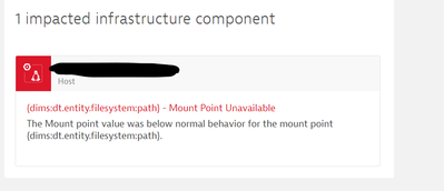

18 Jan 2024 03:45 PM
Hi Florent,
Event this parameter is not working

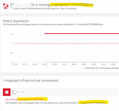

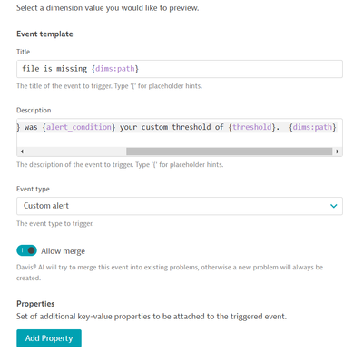

19 Jan 2024 09:30 AM
Which version of the extension are you using? I have re-retested and {dims:path} actually work for me:
