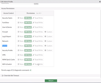

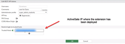

The Fortigate on AWS has been configured in the following way:
Rest API user profile on Fortigate:
The Fortigate firmware is v7.0.5 build0304 (GA).
What I'm missing on this config?
