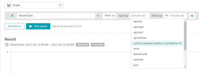

Hi @msavy ,
you could indeed use metrics to ingest the data you are referring to like follows
failureCode,piid="foo",apiorgid="test",apiversion="1.0",requeststart="1682448091736",requestend="1682448092015",apistart="1682448091739",apiend="1682448092013",url="https://localhost:8443/apiman-gateway/test/foo/1.0",method="get",responsecode="200",responsemessage="ok",error="false",custom.request.header.x-correlation-id="1234-4949-4693" 0
I took the value from failureCode since it seems to make the most sense to have it as as a metric data point.
Using a data explorer you could plot the metric data in a graph and filter/split by any of the dimensions passed through
From this you can use metric events to generate problems as needed, display the data on dashboards etc.
You could as well ingest data as logs and extract metrics from the logs or directly throw events from depending on content in the log line.
However from the data you sent it seems you are trying to figure out the state of a specific application depending on the response, we usually do this with synthetic tests. You can define specifically how and when a test fails, you can also define postprocessing scripts to further analyze the payload received from the endpoint you are checking.
Sending this data as events would e.g. make the querying of data a bit more challenging if you want to view the state of your application in a specific timeframe, sending events requires as well some kind of entity in Dynatrace to send the events to.
Hope this helps.
