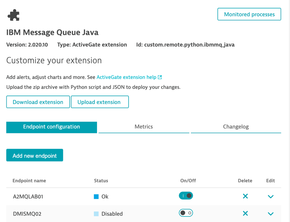

I do have few AG running this extension. Do confirm if you can see the extension processes running on your AG, searching for the connector.jar, you should see at least one process by configured instance.
The logs should be on this dir:
/var/log/dynatrace/supportarchive/remotepluginmodule/log/remoteplugin/custom.remote.python.ibmmq_java
On Dynatrace UI, you can see the endpoint status on "Settings -> Monitoring -> Monitored technologies -> IBM Message Queue Java".
On the button "Monitored Process", you will see the MQ processes list, including the ones collected by the default OneAgents. For find out only the ones from the Extension, just check on the "Custom Devices" page.
