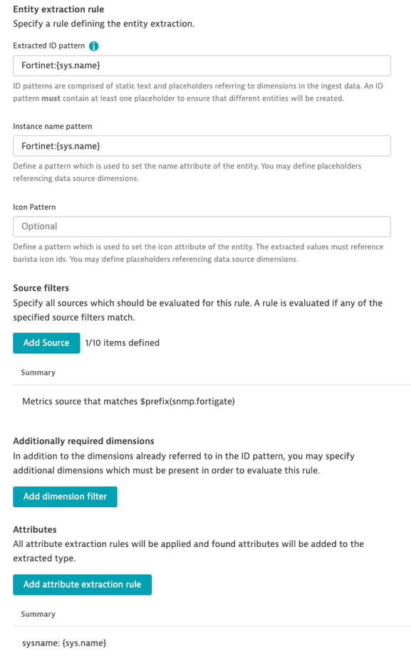

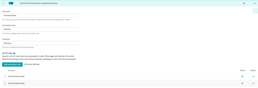

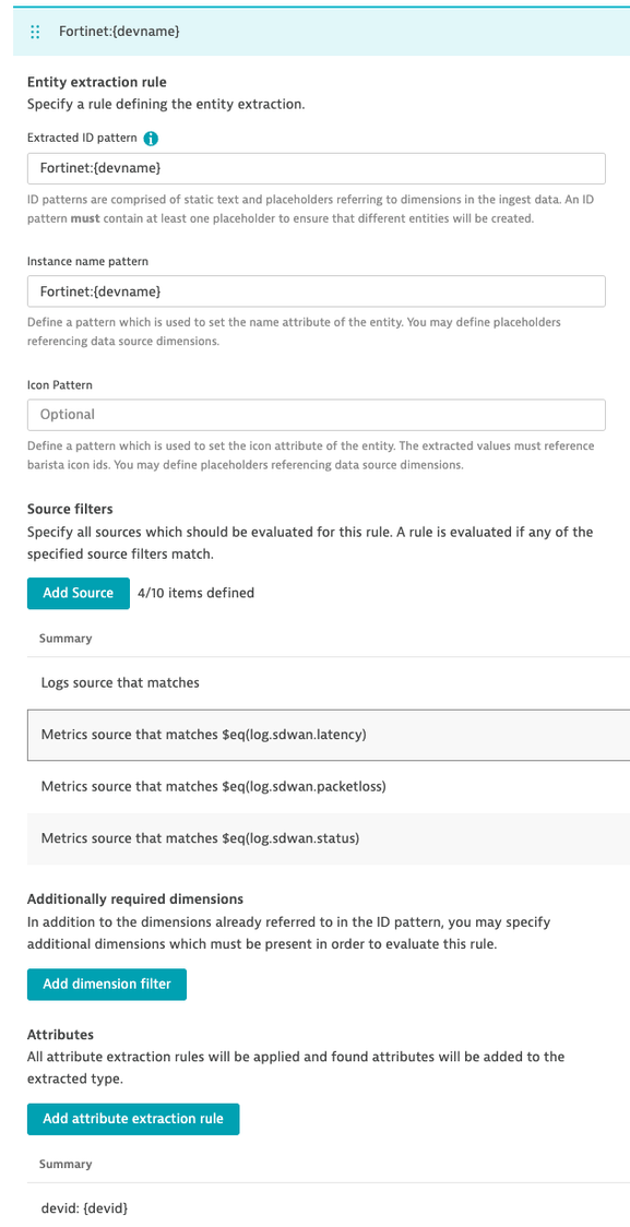

You should use custom Toplogy model to map several datasources in a single entity.
For example :
The first one is about SNMP metrics :
And the second one is about Log metrics :

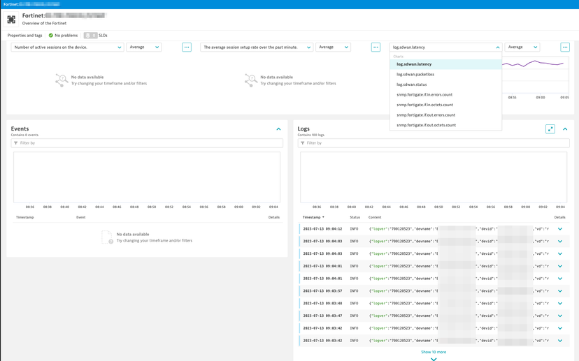

Then you have all your metrics/logs in a single entity page (and Davis can correlate them :)) :
Sadly you can't organize your tiles from GUI for now.
You need to have a push a proper Unified Analysis template via extension :
