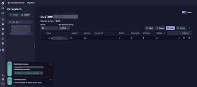

14 Jan 2025 12:35 PM
@erh_inetum, thank you for the response.
I'm using feature 'custom extension creator'. Which I think, doesn't require to upload the extension to tenant. Post generating developer.pem and adding ca.pem to cred vault and ActiveGate, we just have to deploy it from the extension creator page itself and it will start showing under hub page as self authored extension.
Adding screenshot below for information.
Regards,
AK
