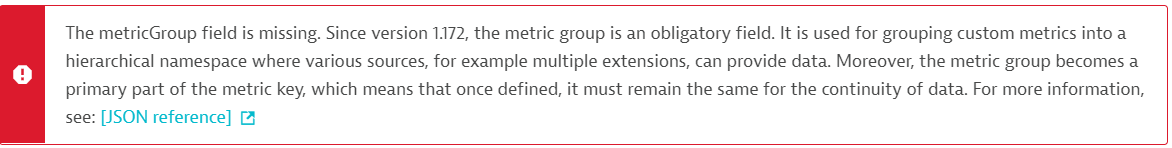

08 Jul 2020 12:12 PM
Hi @Barry L.
Thank you for uploading plugin....I am trying to run this plugin but it does not work..its getting below error...could you please help me to resolve this..

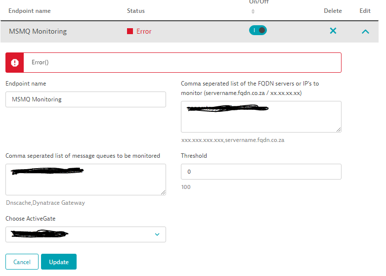

Hi Barry,
We used your plugin and installed ActiveGate in one new host, we have not installed OneAgent into that host. Provided all required details of another host like server name and queue name and Copied Plugin files into "C:\Program Files\dynatrace\remotepluginmodule\plugin_deployment" location. After that we are getting an error as below screenshot.
Could you please tell me what is the issue? If we missed anything? Tell me how to debug if we face any issues like this in future?
Do we required to install OneAgent into that newly configured host ?
Do we need to install ActiveGate where all the queues are running in that server or different server is also fine?
