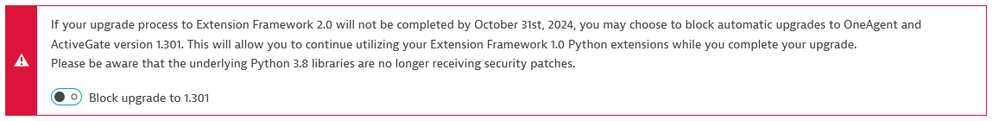

Regarding those who need a plan B, there are several in place, till the end of the month. One of the most important is not permitting automatic updates of ActiveGates/OneAgents, where extensions are needed.
Dynatrace has put another measure in place: in the extensions v1 configuration, you can now also block upgrade to 1.301 there:

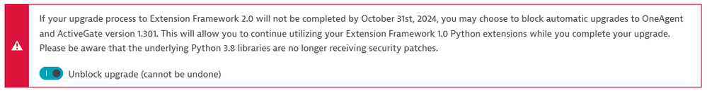

If you select this option, you will then get the following:
