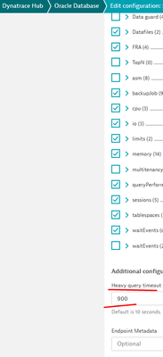

Hi, I wanted to ask if I understand properly this part of the new version 3.2.0 - as till now I thought if I set it to 900sec(15min) this will help me when for some reasons for example a tablespace query needs more time than 10sec to fetch the data from the database. Now please clarify if that field is in seconds or in minutes - what is the minimum and maximum value there we can put?

It is indeed in seconds. The number needs to be at least 1, and it cannot be larger than the interval. Ergo, if a query runs every 5 minutes, the timeout needs to be smaller than 300.
For this specific extension, it needs to be smaller than the two query interval variables.

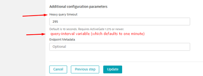

so for the ASM disk data is fetching on every 1 min but for the tablespace on every 5 min and if I set in "heavy-query-timeout" let's say 295sec --> this will be a good approach for the tablespace query but what about the ASM?
What's happening here is that the ASM Disks group, in particular the query under the asm (detailed) feature set, is set to run with the frequency of the query-interval variable (which defaults to one minute), while the tablespaces query is using the heavy-query-interval variable (which defaults to 5 minutes).
When interval variables were added, this was implemented like this for backwards compatibility reasons, as previously the asm (detailed) feature set was running every minute.
Nonetheless, we will look into this and check whether it can be adjusted next release. Honestly, for metrics like disk space, a 5 minute resolution should be enough.

1/ first I saw these errors and the value in the "heavy-query timeout" was set to 900sec(15min):
09:15:45.049 |  | While polling from endpoint *****************, querying group 'ASM Disks' failed
lArgumentException: Timeout 900 seconds cannot be longer than interval 1 minutes.
 09:15:45.195 |  | ERROR |  | While polling from endpoint ************, querying group 'Tablespaces' failed
ArgumentException: Timeout 900 seconds cannot be longer than interval 5 minutes.
2/ I've changed the value to 295sec(5min)
the errors for the tablespaces stopped but continued for the ASM
3/ I've change the value to 0
than this message appeared in the logs: Variable long-running-query-timeout is not numeric. Default timeout will be used.
I know that the default is 10sec
after this change there were no errors for the ASM but this one for tablespace started to appear:
While polling from endpoint *********************, querying group 'Tablespaces' failed
ava.sql.SQLTimeoutException: ORA-01013: user requested cancel of current operation
so 10sec is not enough for data from tablespaces to be extracted, 55sec is not enough too but if I change it to a higher value than 1min(55-60sec) than I break the 1min interval ASM rule....
Is it possible somehow that the change is applied already to the lower versions as well?

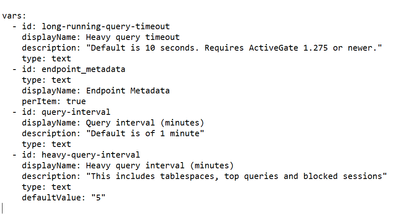

No. Version 3.2.0 added the ability to configure query intervals, but for lower versions the following intervals apply, as per the Hub tile's FAQ (see the second paragraph):
From version 3.2.0 onwards, query execution frequency is controlled by the configuration variables query-interval and heavy-query-interval. Most of the queries executed by the extension will run every query-interval minutes (with a default of 1 minute), while the queries under tablespaces and tablespaces (detailed), Blocked sessions and TopN will run every heavy-query-interval minutes (with a default of 5 minutes).
For older versions, most queries run every minute, with exceptions for the heavy queries mentioned above, which run every 5 minutes.
This means that for versions 3.1.3 and below, the Tablespaces query is running every 5 minutes, while the ASM Disks query is running every minute, so it is expected you would run into the behavior you are describing above.

The "new thing" with 3.2.0 was the addition of configurable query intervals. Two new variables were introduced, query-interval and heavy-query-interval, the former to control the frequency of all queries which previously ran every minute and the latter to control the frequency of the queries previously running every 5 minutes.
These variables default to 1 and 5 minutes respectively, meaning that if you upgrade and don't change those variables, you will indeed see no difference in behavior.
