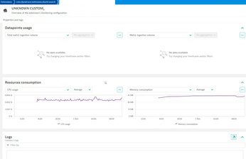

I have an ElasticSearch extension installed on one of my environments. Despite the correct configuration, only the CPU and Memory metrics appear. I do not have any log entries indicating errors.
Has anyone encountered this problem?

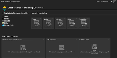

Hi @radek_jasinski ! It seems that you are looking at the "technical" extension metrics view. Here, the CPU and RAM metrics are related to the extension's system usage on the host or ActiveGate.
Do you have metrics or entity in the preset dashboard ?

Hi @jegron
I don't have any metrics available on that cockpit you showed. I also verified the metrics that are available from this plugin and I don't have a value anywhere.
