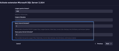

This is exposed in the configuration in the latest version. You can control the query intervals by setting these values:
So there should be no need to make a custom version and change the yaml. However, if you ever need to this is documented here: https://docs.dynatrace.com/docs/shortlink/sql-reference#interval
