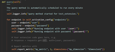

The Extension was built on Windows server. But , it does not have anything which should be windows specific. Below is the snip of code:
That looks fine. You or support would have to look at the log files of the extension execution controller.
