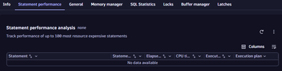

Hi Team,
I'm trying to get the statement performance data over latest DT UI for MsSQL DB. We have configured Extension for the same successfully but unable to get the data. I have attached snip for reference. Kindly assist.

Hi @Deepak_Shingote , I'm curious if you found a solution to this problem. I see the same issue in my newly setup extension. Other database information for MSSQL is available such as latches, locks, blocks, logins, uptime, cpu, memory, etc, but the "statement performance analysis" section is blank. This is across all SQL servers in our environment, which are Azure Managed Instances.

Based on the above replies, and some experimentation, I think I understand the problem and the solution. The solution seems to be that we have to individually connect to each database using the SQL server extension. In our environment, we have hundreds of databases on just a few servers, so this would be quite tedious. Has anyone been able to add a server connection without specifying a database, and have the "statement performance analysis" check the query logs for all databases on that server?
