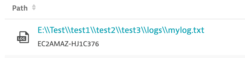

Yes its already added in custom log source, but regarding the path i just checked for other applications we can see the path is not a concern , even for the log output on the fourth level we are capturing the logs
