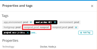

here's an example of a process group that was tagged by auto-tagging rule: nonprod_prod: nonprod the rule did not get re-evaluated and change the value to nonprod_prod: prod even with PG inactivity less than 24 hours. This PG is inactive for 4 days as of now.
Thanks. Tibebe

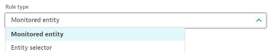

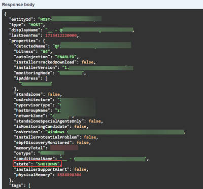

The issue at hand is trying to alter tags on entities after the agent is off/removed, which is ultimately no longer monitored and tags apply only to monitored entities.
Your solution - Use Entity Selector. I myself found it problematic to tag a host that is no longer seen such as inactive, uninstalled etc... So to complete this, you would want to write an entity selector that targets all entities, or even just K8 entities where the Last time seen = X, or based off the state value. I had a use case where we needed to query properties details and your need will qualify for the use of the properties as well. I would target the state. This will allow you to target all the entities and then provide the tag results based off the property field which is always present.
