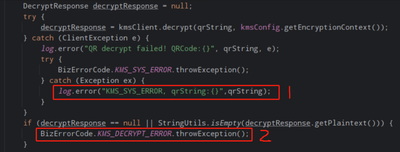

We have a requirement from the customer to capture the log.error message (highlighted as 1 in the attached snapshot). Currently, we are only see the second exception captured to BizErrorCode.
Could someone guide us on how we can ensure the log.error exception is captured in Dynatrace? If there are specific configurations, such as logging integration or API usage, please let us know the steps to achieve this.

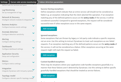

By default, the exception should be captured and you can find more when you configure the agent.
From the documentation:
https://docs.dynatrace.com/docs/shortlink/service-failure-detection
By default, Dynatrace detects:
  • Programming exceptions (Java, .NET, Node.js, and PHP) as the reason for failed requests when exceptions result in the abort of service calls.
If still not captured, you can define custom exception detection, using this.
https://docs.dynatrace.com/docs/shortlink/service-failure-detection#general
Screenshot from my lab:

Hi @RohitBisht @AntonPineiro ,
We tried using custom exceptions and capturing them with the request attribute method, but it seems that the logs generated by the SLF4J framework are not tied to the class as expected. The issue is that the logs appear to be generated independently of the class, and this approach doesn't seem to work.
Could you please suggest a solution for capturing these logs, especially since the customer is not using log monitoring
