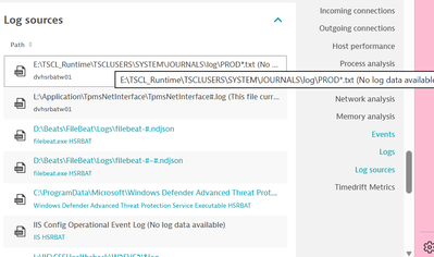

Hi @Gert  ,
I also tried ingesting from a log source called E:\TSCL_Runtime\TSCLUSERS\SYSTEM\JOURNALS\log\PROD*.txt (No  log data available) but didn't get any log data . the only catch here is that i have placed some log files here in this folder as a POC to check if we can actually see the logs from this location or not . Apparently DT one agent is able to read the location but not the logs inside .  Any help here !!

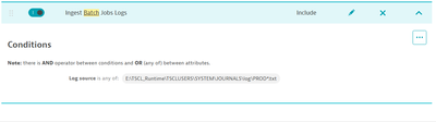

Which ingestion rule have you created to ingest that log?
Best regards
is there any other way or please guide if I am doing something wrong here
I have updated the ingestion rules as : E:\TSCL_Runtime\TSCLUSERS\SYSTEM\JOURNALS\log\Jobs\PROD*.txt . Still no response
