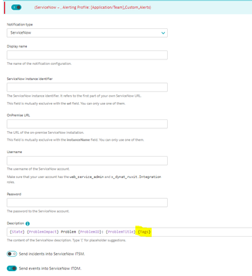

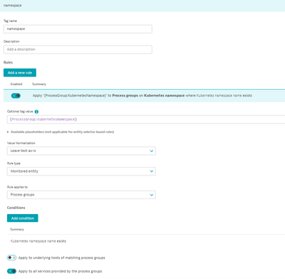

While putting placeholders in the custom event description will result in that data showing up in ServiceNow you can also add additional details in the problem notification settings.
In the case of Kubernetes Namespace, I would suggest creating an automated tag that uses the {ProcessGroup:KubernetesNamespace} placeholder that will create a namespace tag on every kubernetes entity. From there if you configure your problem notification to send through tags then the namespace will appear in your description.
