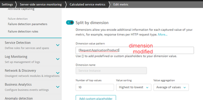

You can change the dimension value, so you could put in a new dimension and let the metric be calculated for those.
Nevertheless, the dimension name you gave it before, you cannot change. So if you change from the dimension value from {RequestAttribute:A} to {RequestAtrribute:B}, the name of the dimension that you gave before (also what will show up in the data explorer and placeholders) will not adjust. So if you called it Request Attribute A, it will still be called that way.

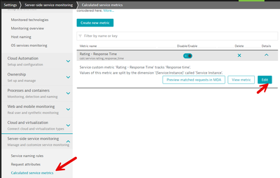

Settings>Server-Side service monitoring > Calculated service metric

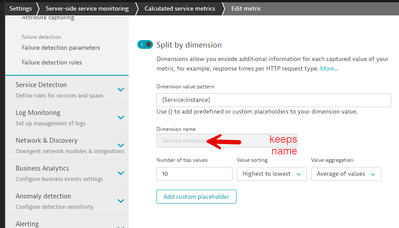

@marina_pollehn already explained it, the dimension keeps the name.
