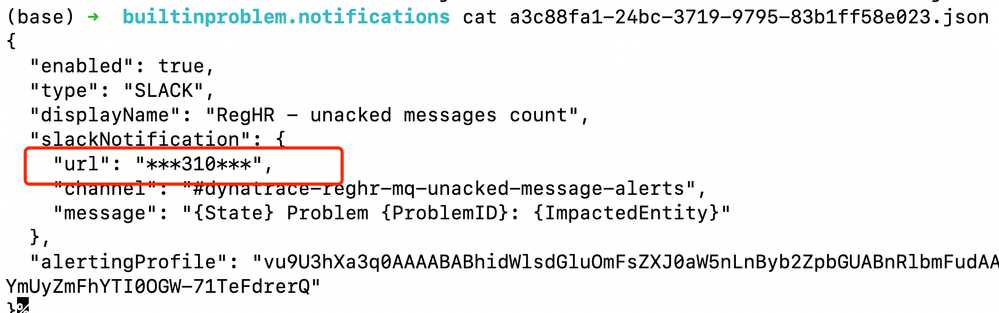

For instance, if 'Problem Notifications' include a Slack webhook (URL) with a secret, would it still be possible to download this valid URL value using Monaco? Additionally, how does Monaco deploy handle such a scenario? Can we set a non-secret URL in the JSON payload for this purpose? or using env variable instead write a non-secret URL?

I would suggest you to create that problem notification integration in the UI and download all tenants configurations with "monaco download" and checking what is written in YAML and JSON files.

HI @AntonPineiro @gbaudart , Thanks for your answers.
This is what I donwload here, I just want to confirm what if I monaco deploy such json to the target dynatrace env, this URL will not working right? this need manually to set URL on target dynatrace env. am I correct?

Yes, If you have multiple environments, you will need to create variables for ID/Urls, etc.
You can do it with the "extractedIDs" parameters

For example set system env variable "$extractedIDs" as URL value, and in the json file using "$extractedIDs" then using monaco deploy to set my slack URL, My understanding correct?

In Monaco, for each conf, you must have 2 file. One JSON that its your conf information, and one Yaml that contains variables, environments etc.
I'm taking one of my dashboard conf to show you a example :
JSON :
"name": "Service or request",
"tileType": "SERVICE_VERSATILE",
"configured": true,
"bounds": {
"top": 2622,
"left": 0,
"width": 532,
"height": 304
"tileFilter": {},
"isAutoRefreshDisabled": false,
"assignedEntities": [
"{{ .extractedIDs.id_your_variable_name }}"YAML :
- id: YOUR_DASHBOARD_ID
config:
template: your_dashboard_json.json
skip: false
environmentOverrides:
- environment: your_environment_1
override:
skip: false
parameters:
extractedIDs:
type: value
value:
id_your_variable_name: SERVICE-IDXXX
- environment: your_environment_2
override:
skip: false
parameters:
extractedIDs:
type: value
value:
type:
api: dashboard
