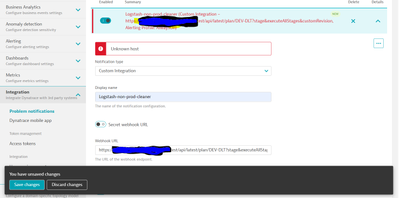

Hi, I am trying to use Webhook integration but I am getting an 'unknown host' error when I put the Webhook url (BitBucket url). Is there any recommended solution to this?
Last one, I was trying use DT problem as a plan build trigger on Bamboo, read that the in order to trigger the build a remote trigger from Bamboo should be enabled which I was doing but it needs an IP from source which is DT on this point. We are using Saas, I am stuck on the IP or CIDRs.

Hi, I get the error when configuring the HTTP url

Hi, yes. It does take requests. So the error is in DT but on this one I was trying with Bamboo
@Itani_ML
Okay, I am assuming that the destination is a local host?
Example: https://myhost1:8443/rest/api/*******
If the host is internal, Dynatrace won't be able to see it publicly so we throw the error "Unknown Host". I suggest looking at this blog IP Addresses for Notifications for starters
The endpoint Dynatrace is connecting to needs to allow public communication to our SaaS endpoints above, so we can see it as available.
Can you confirm? 🙂
Thanks,
Lawrence
Hi, yes you are right. Thanks for the help.
