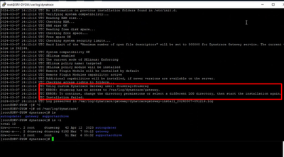

We had an outage of the activeGate server. The server was running an old version and tried to upgrade to 1.285 but failed causing that oneagents and activeGate where offline 15 hours.
to solve the issue we tried to install a new activeGate on the server (linux S.O) but installation failed with
ERROR: dtuserag has no acces to var/log/dynatrace/gateway ....Installation failed.

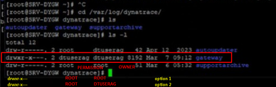

Maybe im getting it wrong, you meant instead of having dtuserag dtuserag, it must appear as the option2 (root root, as you say) in the example image and then apply a chmod 755 to var/log/dynatrace/gateway ?
08 Mar 2024 03:40 PM
Yes that is correct. On my AG, folders are assigned to root but my other users/group are at minimal allowed to read/execute.
