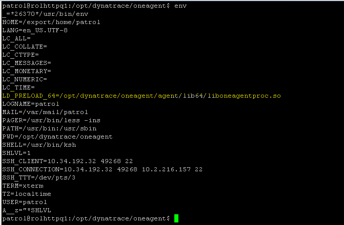

Hello @Julius L.
Have a look in the below screenshots, where we configured the environment and the output of that environment.
Did we miss something?
