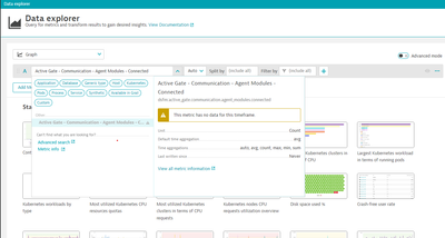

Hello @victor_balbuena,
I have tried using the metric Active Gate - Communication - Agent Modules - Connected but i see no data even when tried for last 365 days, i am getting this message "This metric has no data for this timeframe." I tried removing all the filters but still the same. Please advice.

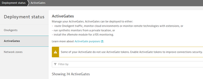

11 Dec 2023 04:54 PM
If you go to Deploy dynatrace and over to ActiveGates, do you see any ActiveGates in there? These metrics that start with dsfm should be available in every SaaS and Manage cluster .
11 Dec 2023 05:54 PM
Yes i see 74 ActiveGates. We have 6 environments and its the same in all "No data"
