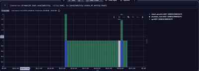

Hey Anton, just tested it out in my environment, the metric mentioned above can be used as seen here:
You could script over the metric to ingest the changes as events but given the above requirements it would probably be easier to have the workflow run every minute and just check the metric. Unfortunately not as efficient as listening for events.

I am trying to replicate those queries but I cannot find those events. I can see shutdown status in metric:

Hey Anton, sorry I had forgotten that those events were unique to the environment I was using so they did not apply generally. Seems out of the box that the best solution is the metric. Sorry for any confusion!
