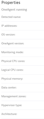

Despite having assigned it to the host in that order, when I go to the interface to visualize the data, it doesn't appear.

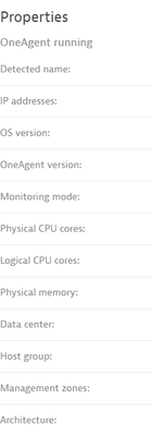

Example of how it should appear.

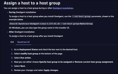

But you can confirm if the assignment takes effect checking the list of hosts by hostgroup in UI:

It is weird, you can try from Dynatrace UI also, just to compare if you notice differences.
Best regards
02 Feb 2024 12:39 PM
Thank you very much for the input. I will make the change through that method, and I hope the host accepts it. In theory, it should work 🙂
